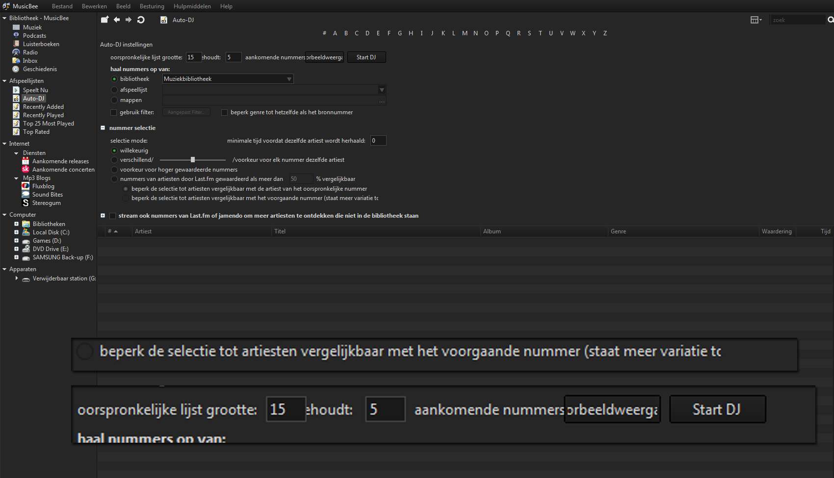

Serious [Q]:
when i host my language file on google code and i need to choose a lisence, which one do i need to choose? This because of legacy issues? Thanks in advance
also:
