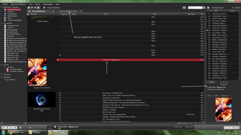

The latest exe does give me problems with the artist tab not being updated. (i did clean install) and the problem is still here
http://i350.photobucket.com/albums/q429/Silasje1/lulz.jpg
HDMI GTX570->YAMAHA RX-V471->DALI ZENSOR 1
Dutch Translation
WMP 12 Skin
  • Posts: 34973
the screenshot you have, the artist field is blank for the playing track. In that case it doesnt update the artist tab. That behavior has been the same from the start
