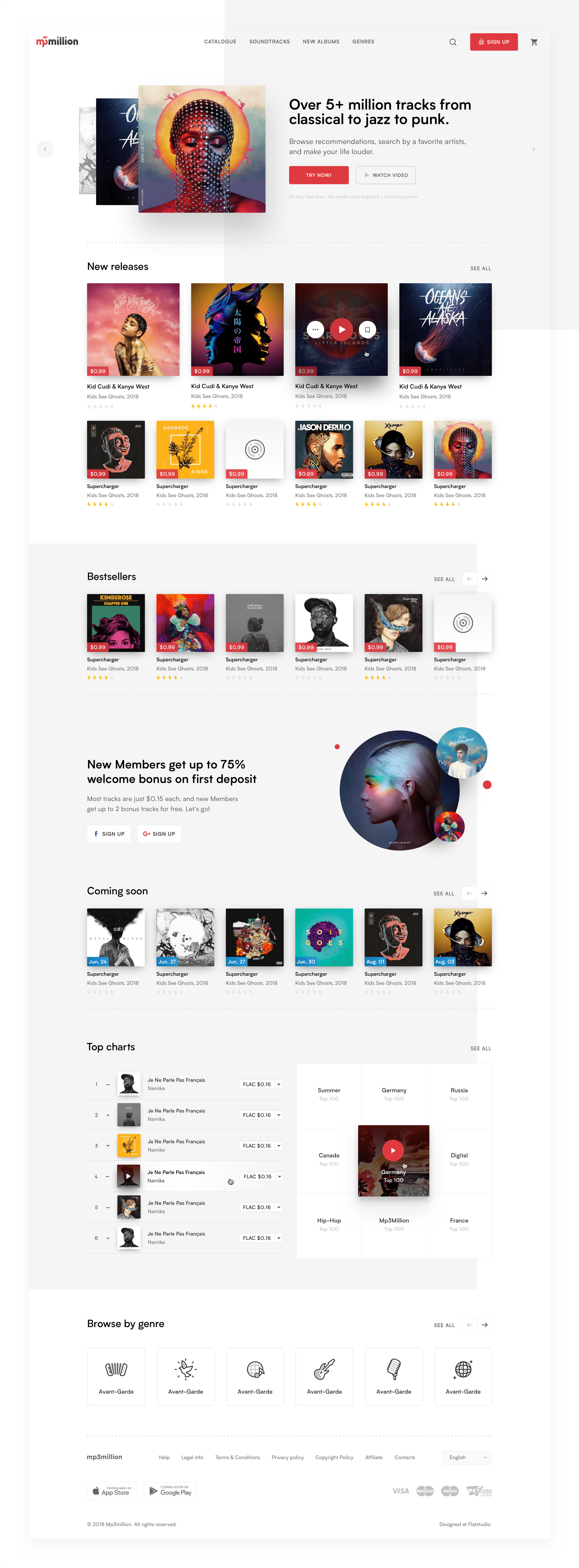

Let me preface this by saying I unfortunately don't know anything about coding nor designing.
I'd like a shadow from an ambient light around the album art. Or a combination of an ambient light an a key light right above the album art like here: https://m2.material.io/design/environment/light-shadows.html#light
I'm thinking to get closer to that, maybe it's possible to increases the size of the shadow, increase the blurring, reduce the opacity.
Offsetting the shadow layer only down and not to the right.
Maybe using 2 layers. One for ambient light, one for key light.
But yeah, if it's like paint.net without an UI, I take it it's not trivial what I'm asking right now  ::)
Maybe some settings could be exposed to the users. The most obvious one would be the opacity.
edit: here are some examples I found that I think look decent:
- https://flatstudbucket.s3.amazonaws.com/uploads/component/field_image/1345/1433-block_12_2x.png
- https://cdn.dribbble.com/users/779743/screenshots/5947881/attachments/1279168/apple_music_home_2x.png
Last Edit: December 29, 2024, 04:00:42 PM by Haste
