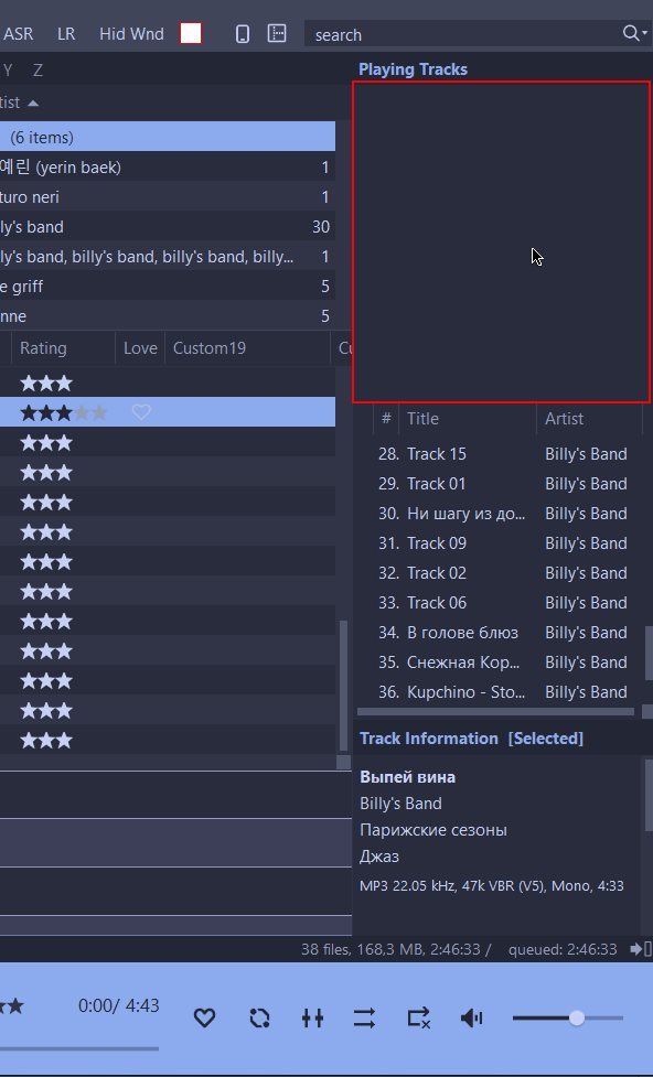

new version shows only blank (black) rectangle. right-click menu is inaccessible too.
Well that's disappointing. Is there anything in the error log?
no, nothing related to VUMeter in error log. clean plugin reinstallation didn't help either.
p.s. i noticed that SharpGL library(-ies) is not included in plugin's zip. is this OK?

  • Posts: 951
The good news is I have a system here that is behaving the same way so that should make it easier to troubleshoot.
The bad news is I still don't know how to fix it.
It's producing a MissingMethodException error for the command that sets the new rendering method. But the method is there because it works on other machines.... I thought it might be a NET version issue but the plugin is set to target Net 4.6.2 and the machine has that installed.
Open to ideas.... I've tried cleaning and rebuilding it in Visual Studio but no dice.
  • Posts: 5309
could you set the project to target .Net 4.8? (4.8, but not 4.8.1, is the last .Net version available for Win7)
at least MB itself is targeted to 4.8
BoringName
  • Posts: 951
I could be wrong but I believe 4.6.2 is the highest you can go for plugins. If you target higher they won't initialise in Musicbee.
Both systems I have here are on the exact same version of windows 10. Works on my main PC but the other one throws the exception. Tried installing all the 4x net versions but the installer says they are already installed.
I compiled my own SharpGL DLL's and set them to target 4.6.2 and get the same result. The nuget package only targets 4.5 and 4.7.2
I've had a few bourbons and bad things happen when I troubleshoot half tanked so I'll give it another crack tomorrow.
