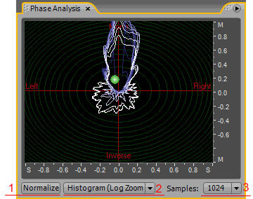

- phase meter tool - basically it projects the left and right signals on the x and y axis. The color of the separate line segments correspond to the signal's phase or line's angle.
- phase histogram tool - uses the same colored phase concept, but arranges the information more neatly as a circular histogram with radius 1.

The colored phase measurement originates with CoolEdit, but later Audition declined the usage of full color, which was professional but wasn't cool anymore.
How to interpret the phase measurements:
When the signal is aranged around the right diagonal (0 or 180 degrees), it is said to be in-phase (or mono), and when around the left diagonal (+90/-90 degrees) - out-of-phase (or inverse). When the diagram widens around the right diagonal, the surround effect increases.
This is the phase meter output for a sinusoidal signal, with some (forgotten, but unimportant) degree of phase difference between the channels:
