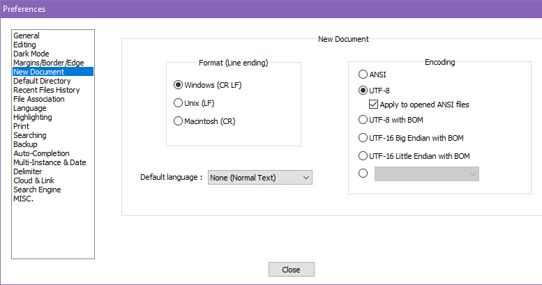

You should probably be looking at how you have setup your macro's to copy text to the clipboard.
This isn't an issue on my macro. The text here isn't even due to a macro, nor has it changed ever since. Text from my screen was manually input. Even a regular manual linebreak doesn't desplay a carriaage return character, and i've never had to manually add it to my macro or any kind of text.
  • Posts: 9133
Then something must have changed with your notepad++ settings.
E.g. check this:
Fivda
  • Posts: 82
E.g. check this:
Exact same...
  • Posts: 9133
Exact same...
That's very strange.
With the setting like that notepad++ should be adding [CR][LF] at the end of a line when you press [Enter]
So in your case that is not happening?
Are you testing this with new documents created in notepad++ , or with existing documents that you open with notepad++ that perhaps are already in some UNIX formatting?
Fivda
  • Posts: 82
Exact same...
Holy crap i think that was it. i was just in a generic unsaved "new1" file all this time so i didn't think about closing the file itself and reloading it from scratch, so i guess i must have pressed a hotkey that deactivated it in the file itself or something...? well at least now it works and that's what matters. thanks a lot
