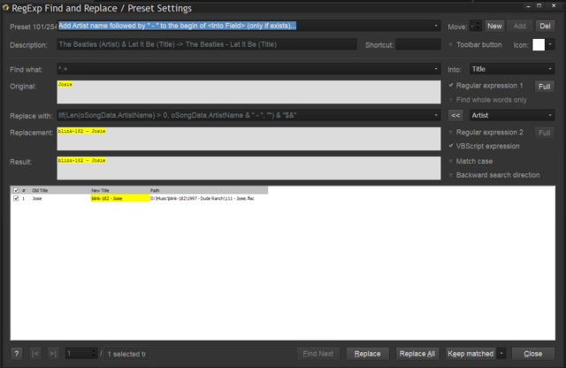

Could someone direct me to a guide on creating presets that a not so savvy person might understand. I'm trying to recreate this preset i used a lot in mediamonkey
the screenshot is too small. i can't read anything on it.

Dizza17
  • Posts: 192
@ aiagm
Without it being in front of me, that looks similar to a preset ASR. Find which one is closest to what you’re looking for then click copy. This will generate a new version that you can edit to suit your needs.
Hope this helps
Cheers Aaron
