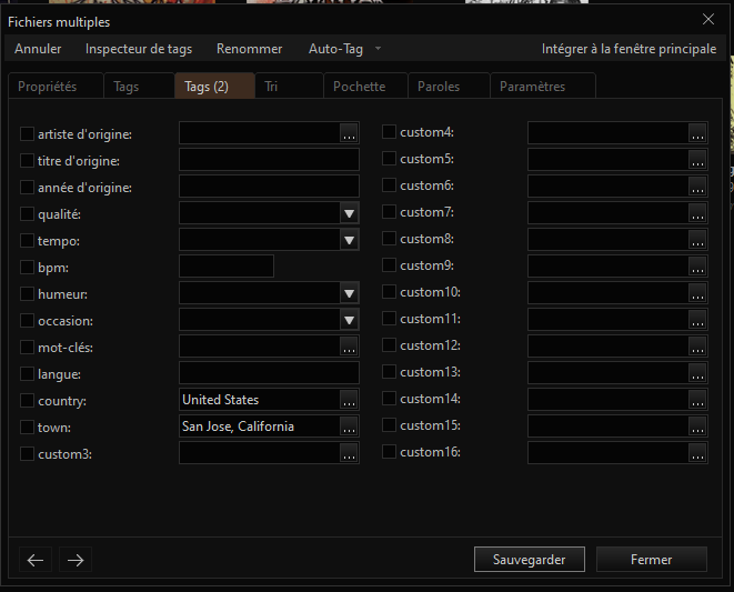

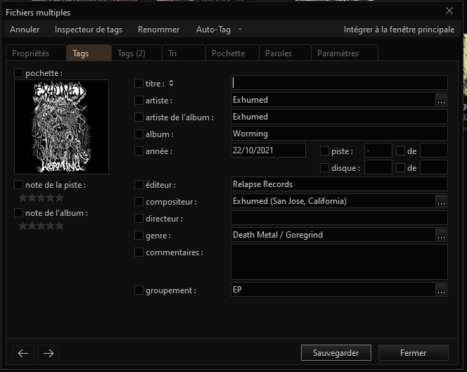

It works great with the band you tried but half of the time, in my case, both Deezer en Genius return nothing (in "normal" mode) or wrong lyrics (with the "fuzzy" mode). So I unticked all the fuzzy options and let only the other providers.
I found another track that causes me some problems (but proves again you were right  ;)  ).
If I use my old way of tagging it does not work :
If I strip the country name and the brackets, it works great :

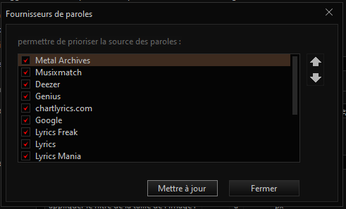

  • Posts: 9166
I tried that track (without country) using the exact same providers your screenshot shows, and I don't get lyrics retrieved at all.
(so google didn't get it either)
Do you know which provider retrieved it for you?
Is it one that is below the visible ones in your screenshot?

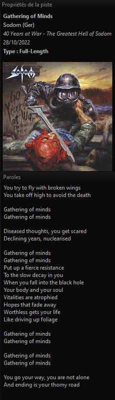

Gauld
  • Posts: 13
It's the first one, Metal Archives :
I've just redone the test :
Sodom (Ger) => Does not retreive any lyrics
Sodom => Works fine in this case.

Gauld
  • Posts: 13
Note that I removed the original regex line and replaced it with a new one.
The original line should probably not be removed, but I don't know if you can have two regex lines in a yml, or that they could perhaps be combined into one somehow.
Hopefully somebody more experienced can clear that up.
So it's best to consider my attempt as a beta test that probably needs to be refined and improved by somebody who has better understanding of this stuff.
Thanks man it works !
I started tu use a free custom tag renamed as "Country" to use as a "group by" option for now. I'll see if I start editing my whole playlist and get rid of the actual Band (Country) stuff.
Quote
P.S.
So in hindsight, this was never about the Google yml?
Yes, in a way, when I had a "no lyrics found " I started using the right click option "Google search" to copy and paste the lyrics in MusicBee and saved it in the .MP3 file. So I thought I needed to update the Google.yml file, but maybe I'm wrong and this Google search option is a built in stuff in MusicBee and have nothing to do with this plugin...
Last Edit: October 31, 2022, 12:43:38 AM by Gauld

Gauld
  • Posts: 13
And/or what you can do, create a virtual tag like:
Artist (c)
<Artist>$IsNull(<Country>,," ("<Country>")")
Then you could use that one for displaying, filtering, playlists etc., while plugins such as LyricsReloaded, but also things like MusicBee's artwork retrieval will still use the regular Artist tag to get good results.
P.S.
This formula assumes you populate the Country tag like: Ger, and not like (Ger)
Thanks again, I've created a virtual tag like you said, it works like a charm !
I've also added a "town" tag to try to get rid off this kind of problems :
But for now I'm still testing the best way to display the result.
But this is no more a LyricsReloaded plug-in issue but more of a general MusicBee topic I guess.
Thank you for your time.
