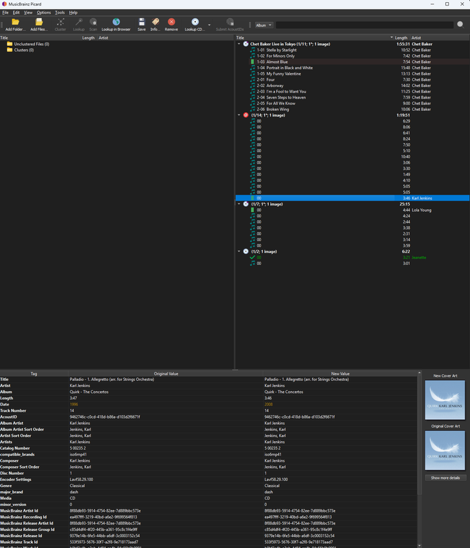

I don't know if I'm doing something wrong but the unset tags script makes the release tile on the top right pane invisible and all the tracks look like "00", the bottom pane is fine, though, it still finds the tracks and they have their tags set correctly as far as I'm aware, the problem seems to be just on the top right pane. I've reset Picard twice to check and it really only happens once I add and enable this script. I've used it before on a previous Picard version on MacOS and it worked fine. But on this up to date version of Picard on Windows, it's giving me trouble.
  • Posts: 9149
I don't know if I'm doing something wrong but the unset tags script makes the release tile on the top right pane invisible and all the tracks look…
Welcome to the forum Roper
I'm not sure if it has always been the case, but indeed Picard won't display tags there that have been unset in a script.
But the scripts are working correctly still, correct?
What you could do if it bothers you is removing tags such as 'album' 'artist' 'title' from the unset script, and then add them to your 'preserve tags' list.
I'm pretty sure they will then show up.
