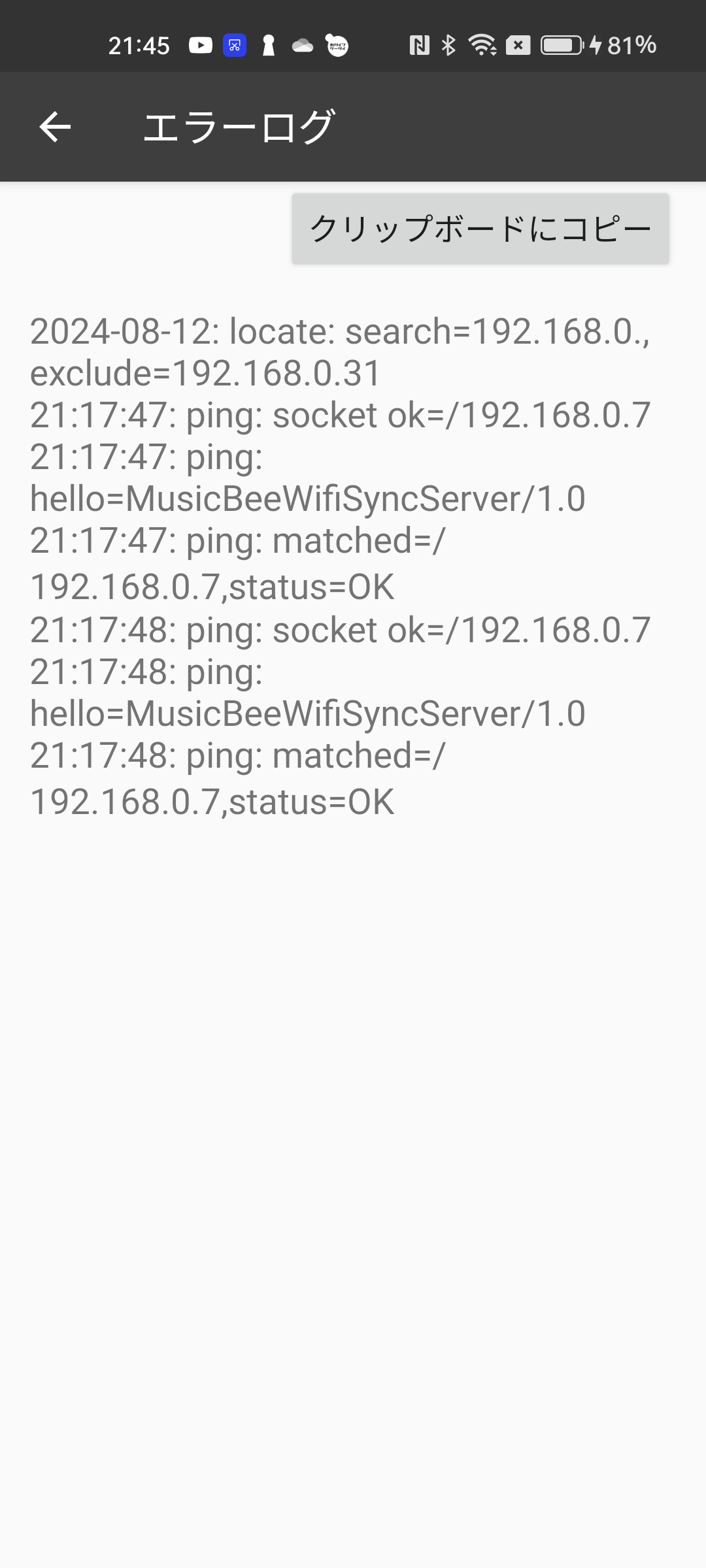

kimt1688
  • Posts: 109
But I can repeat the bug by doing the following.
Start musicbee
Perform a sync.
Close Musicbee and completely close the musicbee wifi app.
Open the wife app and attempt to sync or click preview.
The first time this gives me an android message that musicbee wifi app has crashed. Any repeated attempts just seem to minimise the app. If I tap the square button on the phone it lists the musicbee wifi app as if it's still running and if I tap it the sync options screen displays but repeated attempts to sync just minimise it again. Even if I force close the app and try again I get the same result.
A little time has passed, but I have indeed identified the phenomenon and made a fix for this bug.
I will paste a screenshot.
Sorry for the Japanese message.
The string shown in the dialog is the same as the one shown in red in the main window.
You can now try previewing and synchronizing as many times as you like by tapping “OK” to clear this dialog.
The bug was present in the attempt to display this dialog and the dialog was failing to appear.

  • Posts: 10270
Is the network stable?
The network is definitely stable. I'm using the compiled APK version of the WiFi Sync app with another Samsung phone and it's working with no issues.
I just tried again after restating both the PC and the tablet and got the same errors.
From the app:
2024-08-24: ping: socket ok=/192.168.1.101
10:17:11: ping: hello=MusicBeeWifiSyncServer/1.0
10:17:11: ping: matched=/192.168.1.101,status=OK
10:17:18: startSync: preview=true,iteration=0
10:17:18: command: action=SYNC_START
10:17:18: tryStart: connecting /192.168.1.101, attempt=0
10:17:19: tryStart: connected
10:17:19: tryStart: hello=true,fromMB=true,custfiles=false,preview=true,dev=SM-T220,2
10:17:19: storage: path=/storage/D997-3128,root=null
10:17:19: syncDevice: root=/storage/D997-3128,ignoreErrors=false,playlists=false,ratings=false,playcount=false

From MB:
8/24/2024 10:21:00 AM - Add playlist "G:\MusicBee\phred\Playlists\Complete Albums.mbp" Unable to read data from the transport connection: A connection attempt failed because the connected party did not properly respond after a period of time, or established connection failed because connected host has failed to respond.
