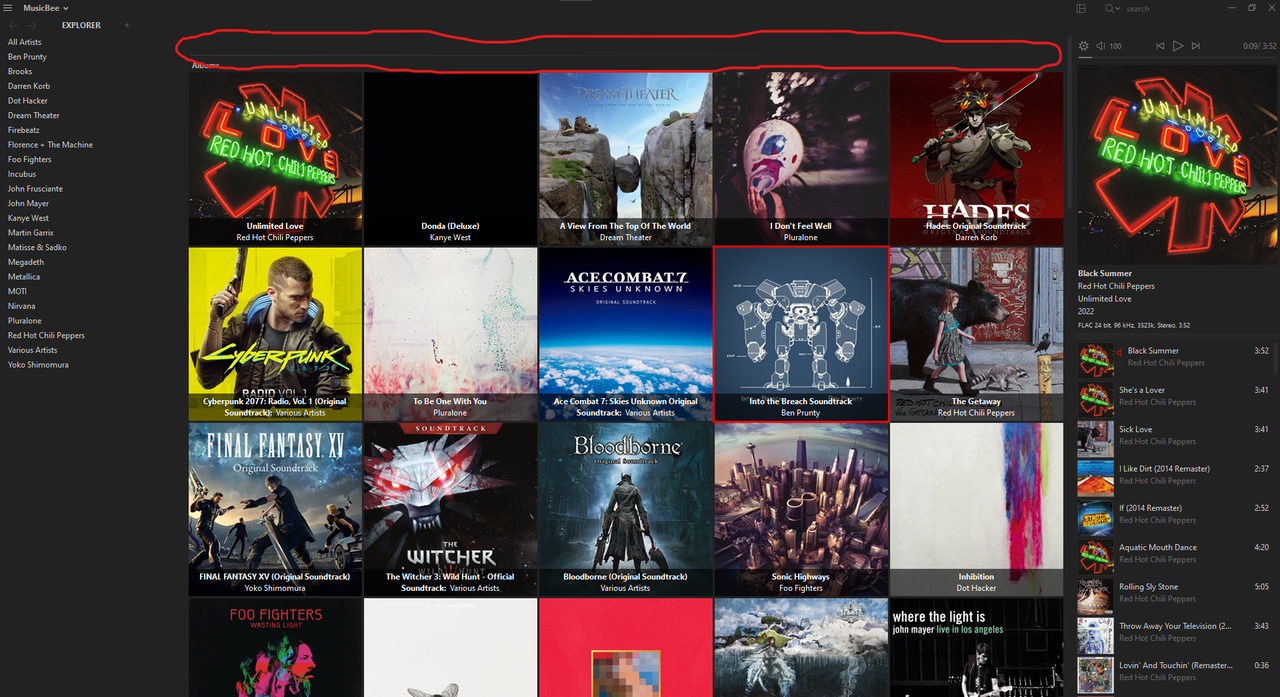

Followed all steps to re-organize Albums, Singles, EPs and Compilations of the way i was looking for.
I'm using the method where the "Group By" section is using the virtual tag that is blank, so in sub-grouping i'm using the virtual tag that really sorts the grouping in the way i want., also the custom sort that i'm using is: Grouping/ Year (Desc)/ Album
But when using this method, there's a line that stands because of the blank tag that i'm using, it bothers me a little, there's a way to remove it or something?
Maybe it's a little hard to see.
