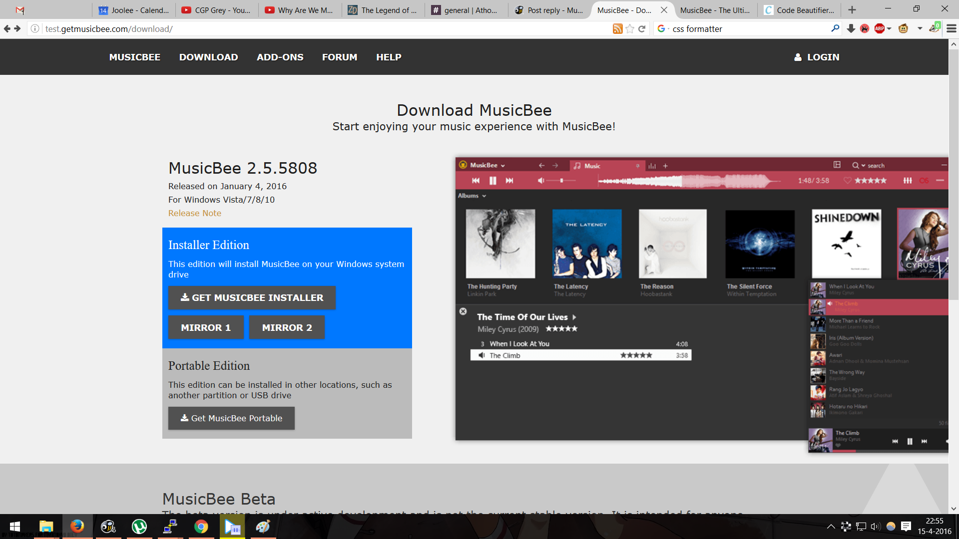

On the download page http://test.getmusicbee.com/download/
 - You pull a serif font out of nowhere (doesn't fit well with the rest)
 - Also, the awesome screen-filling goodness showcased on the homepage is nowhere to be seen. It feels a lot less polished.
I have no idea where did you saw serfi? all fonts are roboto if i didn't make any mistake :/, can you post a screenshot?
Roboto is a non-standard font and I don't see you loading it anywhere in your CSS as webfont. You probably have it installed on your computer so it renders fine for you. Most elements render in Sans-Serif or Verdana on my PC because you configured those as fallback in the body style but for some reason you specify custom font parameters for some elements (.show_info, input, .btn, H1, H3 and .mainmenu) where H3 doesn't have any fallback fonts configured.
As for awesome screen filling goodness, what do you mean by nowhere to be seen?
The homepage is formatted with a lot of free space and (background) images that stretch from left to right. I have configured your H3 tags to display Sans-Serif for me now so I can take a new look at the download page.
At my screen resolution (1080p with 125% DPI scale) the left side of the download screen looks a bit empty. It feels like the whole page is shifted to the right because the screenshot fills the right part of the screen but the left part is empty space. Also, on the homepage, you use generous spacing for everything, for example the feature boxes and hero-buttons. The boxes on the download page feel cramped with a lot less spacing and buttons that seem to big for the space they are allotted. Increase the paddings in the boxes, center the buttons and increase their margins and you'll go a long way to making those boxes feel less cramped. You can also make sure that the right side of the screen has roughly the same amount of empty space as the left side by making the screenshot smaller or just centering the whole page.
Now that I look at it again, it probably doesn't help that the screenshot is cut of at the right side of the page. >Screenshot<
Ah crap, i completely forgot to include roboto from googlefonts :P, it must've slipped my mind when i switched to scss. it should be fixed now.
The button text seems big because of the messed up font it should look good in Roboto.
The boxes are cramped because it does not have that much of context anyway, only few download links and few lines of text. making it bigger does not make any sense.
As for making the screenshot smaller, yes thats what i have in mind. To be fair since the new site is specifically shows MusicBee 3's feature, until MusicBee 3's UI is solid it is hard to get a screenshot for the website. Most of the current screenshots are placeholder. I will update them with new ones when MusicBee 3 UI is finalized.
