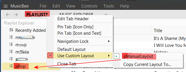

1. I mark a certain playlist
2. I right click on "Playlists" tab and select the previously Custom Layout (= with Manual Sort order!). See attached snapshot 1
3. I mark another playlist
4. I right click on playlist column header and select another sort order (e.g.Artist-Title)
5. I switch back and selected again the playlist from step 1
The previously assigned Custom layout was overwritten by the sort order I assigned to Playlist Layout sort order from  step 4
Thats bad.
It seems to me that selecting a custom Layout is global for all Playlist
I want a certain Sort Order ("Manual") for only one certain Playlist.
This Sort order should be kept regardless of which sort order I specify later for other playlists.
When I revert back to the special playlist then automatically Manual sort order should be active
I expected a layout/sort order definition per playlist not via "Playlists" tab but as on option in Preferences dialog of this playlist X.
But when I go into such a Preferences dialog of Playlist X my custom Layout does not appear (see attached snapshot 2)
So whats wrong?

clsven
  • Posts: 40
My bad... Save your screen as a "View" (it even says, and I even wrote "display using view.") 🤦🏿‍♂️ (It's still good to save both your Layouts and Views, though. I use the same name for each.)
So, what you want to do is set up your Layout and View, then click the Layout-looking button to the left of the search bar at the top of the screen.
Click Main Panel -> Custom Views -> Copy Current View Settings to...
Then it'll be available in the "Edit PlaylistType" drop-down list.
Ok, thank you.....but the problem is still open.
Yes, I created now a customview from currently selected playlist with MANUAL sorting. This custom view is saved and selected  in Playlist Settings of the target Playlist (see attached snapshot).
Now I switch over to another playlist and select a different sorting with Artist-Title. I play some songs.
After that I switch back to my first Playlist and...... the sort order has changed from "Manual" to "Artist-Title" (just as the second playlist).
From what you said the playlist should always pay attention to the "display using view" from its own playlist settings
But this is not the case.
It seems to me that the sort order is NOT part of the custom view definition.
When I look at the custom View XML file (see below) then I cannot find an element similar to
<sortorder>Manual</sortorder>
So is the sort order really a part of a custom view?
