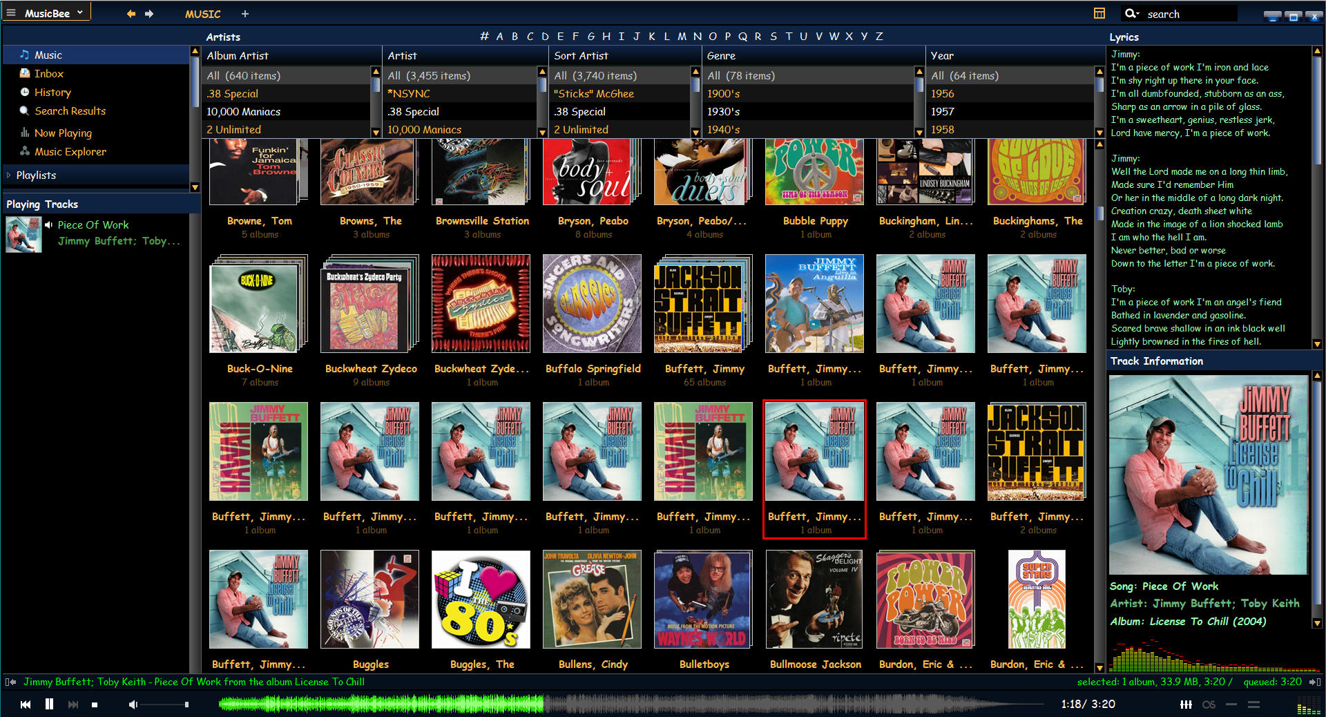

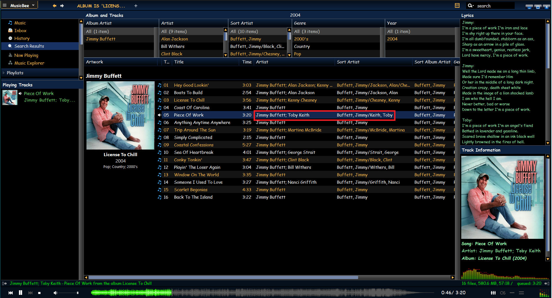

The problem I am encountering is that MusicBee handles the ";" semi-colon separated artists in Artist tag differently than it handles the Sort Artist tag for the same files.
In other words,

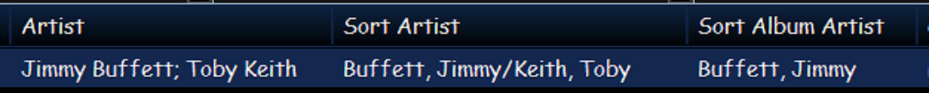

Artist: Jimmy Buffett; Toby Keith gets displayed as Jimmy Buffett; Toby Keith with separate entries. (preferable)
Sort Artist: Buffett; Keith, Toby get displayed and sorted as one combo artist Buffett, Jimmy/Keith, Toby (";" is changed to a "/" and the separate artists are recognized as ONE artist).
This is not desirable for me because albums released by an artist with several duets on the album get all splintered up in the Sort Artist library view.

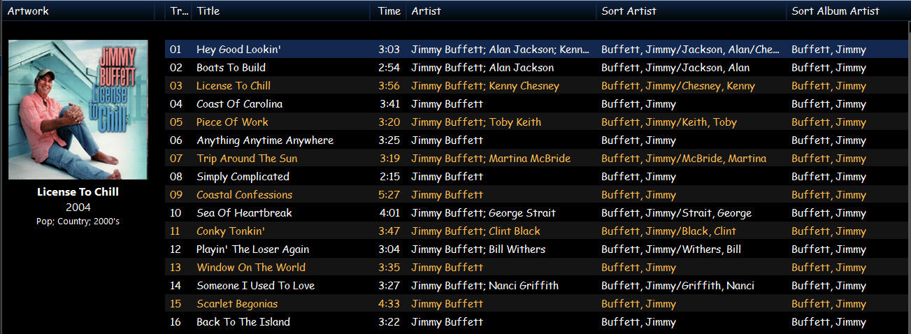

Here is an example of an album released by one singular artist but it has many duets and guest appearances.
This is a nightmare when it creates a new artist entry for each unique combination of duet artists.

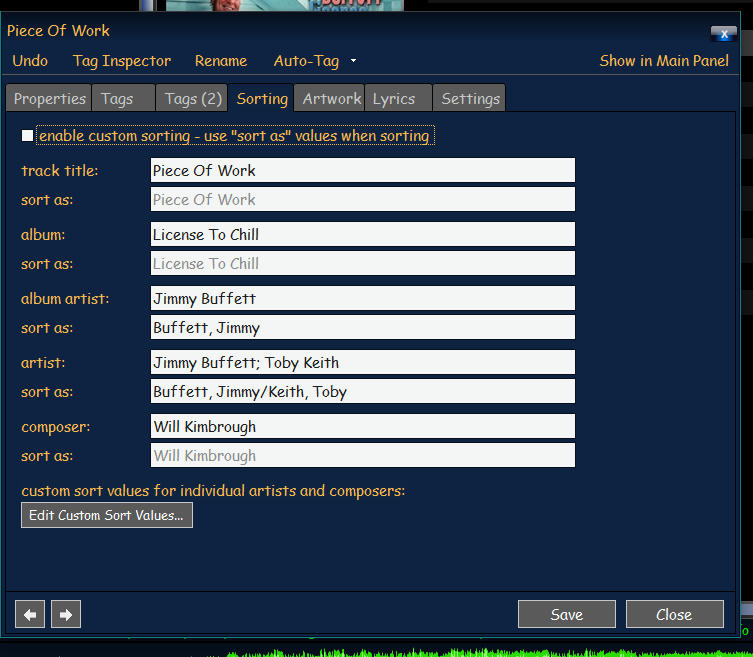

Do you have the custom sort tags enabled on the sorting tab of the tag editor?
Latest beta patch (3.5)
stopbrickwalling
  • Posts: 109
I've never used the tag editor or that screen in MusicBee, so seems the answer is no, it is not checked.
When I do look at that now, the presets for custom sorting do not refer to the Sort Artist tag.
Just to confirm, the Album Artist, Artist, and Sort Album Artist tags are all doing just fine in my application of them.
(I guess I would have problems with Sort Album Artist too if I was inputting multiple values there but I'm not doing that).
I don't want to do anything that will change the current MusicBee behavior with the Album Artist or Artist tags.
  • Posts: 10694
I'm not 100% sure if this is what you want. It might be the opposite. But if you enable the custom sort tags, then each separate artist value can have its own sort value, even when there are multiple artists in a track.
